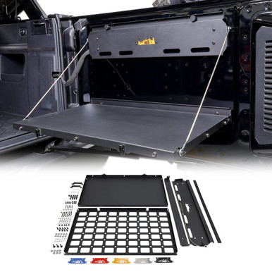

I saw a couple of people in the club with this table. The reports and reviews were good and the price was right (it was a x-mas present :gift:). Here is my quick review of the table and install-
  1. The instructions were terrible. Watch this video for a little better illustration of the install process (there are a few videos on YouTube detailing the process)-
    https://youtu.be/DkK-WhLMLPE?si=142aJB6bAa7EHOik
  2. You need an 8mm, 10mm and 5mm allen head wrench. A plastic interior pry tool is nice to have for the tailgate trim as well.
  3. The bottom mounting studs would not tighten up with the supplied β€œshims”. I used some stainless washers I had with a larger inner diameter and then the tabs on the stud engaged and tightened up great.
The table it’s solid and so far, rattle free. It’s not the biggest or most feature packed, but it will serve well for the occasional camping meal prep table and every day workbench when using the Bronco. I miss my truck tailgate, so I know this will come in handy for me.
Here is the link (it goes on sale for less than $150 on occasion).
I will post any follow up thoughts once I get some use in.

Thanks for sharing. I have the Ford table. It was the only one available when i got it back in 2021. It has been rattle free. I just didnt like that i had to drill into the tail gate to mount the studs to anchor the table.
That looks in some ways similar to my IAG (Which is a rebranded generic one)
I have had my table for a while. I have my trail maintenance gear on the Molle panel and no issues so far. Definitely would recommend it.
